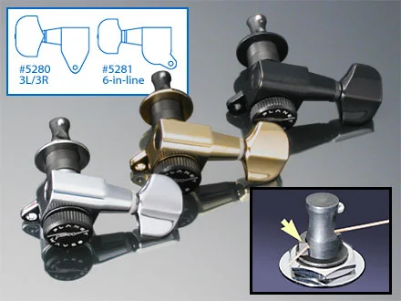

  16. köprüde sorun yoksa locking tuners :wink:
    [​IMG]
    [​IMG]
    [​IMG]
