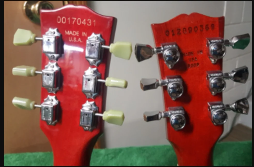

neden saklıyorlar seri no yu meraktan soruyorum
Beyaz seri no=çinli
Siyah seri no=Gibson
Yakında bunu da çözer çinliler.

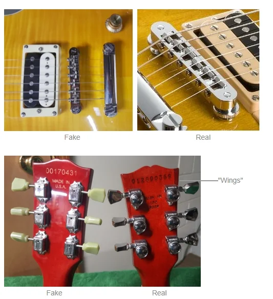

How to Spot a Fake Gibson
1. If the deal seems too good to be true, it probably is. If someone is selling a Les Paul Standard or Slash Signature model for $500, beware.
2. If it doesn’t come with a Gibson case, beware. All higher-end Gibsons come with a Gibson hard case. Less expensive models often come with a Gibson-branded gig bag. That’s not to say that having a Gibson case assures you that it is real. Counterfeiters make fake cases too. But if you meet the seller in a parking lot, and he pulls the guitar out of the car without a case, walk away.
3. Counterfeiters seem to favor more obscure models, like signature models, “Custom Shop” models, unusual colors, etc. I’ve seen more fake Les Paul Supremes than the real deal.
OK, now let’s get to specific features that differentiate fakes from real.
1. The bridge: This is probably the easiest difference to spot. Most fakes have the imported style bridge, which has a ¼” screw post that can be adjusted using a flat screwdriver. Real Gibson bridges have a very small post, and adjustment is made using only the thumbwheels.
2. Fret binding nibs: With the exception of 2014, all Gibsons with bound fingerboards have fret nibs. The frets do not extend over the binding, rather they are cut off inside the bound portion, and the binding is cut around the ends of the fret. This used to be a dead giveaway, but I have seen fakes now with nibs, so it is no longer a sure sign. Also, guitars that have been re-fretted often do not have nibs.
3. Neck construction: With few exceptions, Les Paul necks are one piece with “wings” on each side of the headstock. Gibson has never used scarf joint neck construction.
4. Maple top: Not all Les Pauls have a mahogany body with a maple top, but those that do utilize a thick solid carved cap, not a veneer. The cap is 5/8”-3/4” at its thickest point in the center, tapering to about ¼” at the edges. On models with transparent finishes, you can see the maple as a lighter contrasting strip of wood just below the binding in the cutout, next to the neck. On veneered tops the center line between the bookmatched sides often appears fuzzy. Solid wood tops usually have a nice, well-defined seam.
5. Fingerboards: In recent years, Gibson has offered some different fingerboard woods, but Indian Rosewood has been a mainstay for most models over the years. The exception is the Les Paul Custom and Supreme models, which use an ebony board. If a Custom has a rosewood fingerboard, it’s probably fake.
6. Binding and plastics: Most recent Gibson binding is darker with more of a pinkish hue. Fakes often use lighter, more yellow colored. The control covers on the back of Gibsons are shiny plastic. I’ve seen some fakes with dull or pebbled covers.
7. Serial numbers: Gibson serial numbers are stamped on the back of the headstock, and appear dark. Fake serial numbers often appear white.

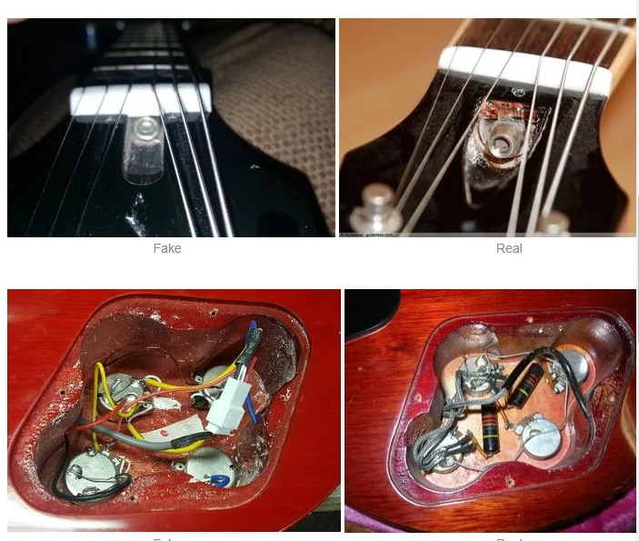

The following indicators require you to remove covers see inside.
8. Truss rod: For now at least, this is the surest way to tell a fake from the real thing. All Gibsons use a traditional style truss rod with a 5/16” nut. Fakes have a female hex nut that takes an allen wrench.
9. Pickups: Gibson pickups use a silver-colored backplate. If the pickups are 2-conductor they will use wire-braided leads. Pickups in fakes often have brass backplates and plastic-covered leads.
10. Electronics: Most Gibsons use full-sized (quarter-sized) CTS or Gibson branded potentiometers. Fakes often use the mini (dime-sized) pots, or if they are full-sized, Alpha or some off-brand.
11. Jack: Gibson uses Switchcraft jacks. Fakes often have cheap import-style jacks.
12. In general, the control cavities of Gibsons appear clean and well defined. Fakes often are roughly cut with gobs of paint, glue, or white polishing compound present.
