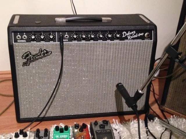

65' Deluxe Reverb Reissue

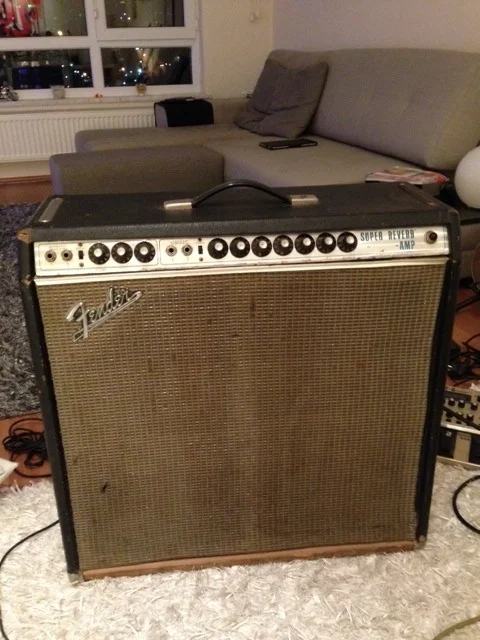

1969 Fender Super Reverb
