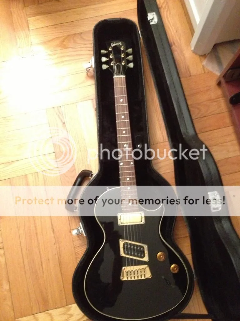

Elimdeki Nighthawk budur:
![DSCF7732_zpsc6fc0cdd.jpg](/proxy.php?image=http%3A%2F%2Fi976.photobucket.com%2Falbums%2Fae241%2Fhackeiommi%2FGreco%2520and%2520Gibson%2520Last%2FDSCF7732_zpsc6fc0cdd.jpg&hash=3df1486d660afecc8e5e04d963c64470)
![DSCF7286_zps17eb0b2b.jpg](/proxy.php?image=http%3A%2F%2Fi976.photobucket.com%2Falbums%2Fae241%2Fhackeiommi%2FDSCF7286_zps17eb0b2b.jpg&hash=76310c67d9f0a6a6af63e5ece55249b5)

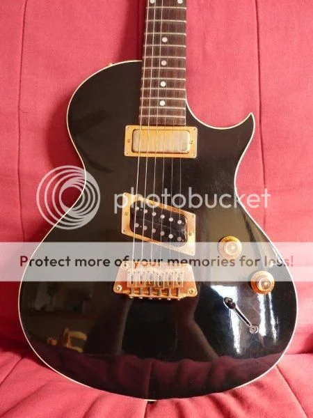

Daha temizleri de böyle görünüyorlar:
![url_zps12940900.jpg](/proxy.php?image=http%3A%2F%2Fi976.photobucket.com%2Falbums%2Fae241%2Fhackeiommi%2FGreco%2520and%2520Gibson%2520Last%2FNighthawk%2520Online%2Furl_zps12940900.jpg&hash=d46d0aa1df452ee31b1c4f193d36e115)
![gibson-nighthawk-special-607039_zpse64bf91a.jpg](/proxy.php?image=http%3A%2F%2Fi976.photobucket.com%2Falbums%2Fae241%2Fhackeiommi%2FGreco%2520and%2520Gibson%2520Last%2FNighthawk%2520Online%2Fgibson-nighthawk-special-607039_zpse64bf91a.jpg&hash=7edb8baf0ba9ee94f290d487429605c0)
![gibson-nighthawk-special-107296_zps89604488.jpg](/proxy.php?image=http%3A%2F%2Fi976.photobucket.com%2Falbums%2Fae241%2Fhackeiommi%2FGreco%2520and%2520Gibson%2520Last%2FNighthawk%2520Online%2Fgibson-nighthawk-special-107296_zps89604488.jpg&hash=9a62f2c990714f19c0b6a7d88a2975fc)
![cknryivpvhmnlts97p34_zps60ea511c.jpg](/proxy.php?image=http%3A%2F%2Fi976.photobucket.com%2Falbums%2Fae241%2Fhackeiommi%2FGreco%2520and%2520Gibson%2520Last%2FNighthawk%2520Online%2Fcknryivpvhmnlts97p34_zps60ea511c.jpg&hash=82776a609a4bbfa6259f9e6f8164f298)
Elimdeki Nighthawk, seri numarasına göre 1995 üretimi. Yakın bir arkadaşıma ait idi. Bildiğim, sevdiğim bir gitardı. Arada satıldı, içim yandı sonra geri geldi ve takasla ben aldım. Aktif olarak sahne ve stüdyoda kullanılmış, görmüş geçirmiş bir gitar. Alabilmek için uzun zaman fırsat kolladım. Potans düğmeleri dışında değişmiş bir parçası yok ki onu da ben değiştirdim keyfime göre.

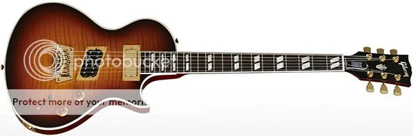

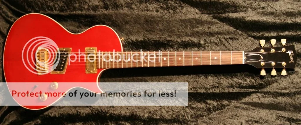

Biraz da resim. Nighthawk Custom:
![custom_zps1ffddca3.jpg](/proxy.php?image=http%3A%2F%2Fi976.photobucket.com%2Falbums%2Fae241%2Fhackeiommi%2FGreco%2520and%2520Gibson%2520Last%2FNighthawk%2520Other%2Fcustom_zps1ffddca3.jpg&hash=1a2303448a502b87719810d4f91c0df8)
![custom2_zpsb32b3fb8.jpg](/proxy.php?image=http%3A%2F%2Fi976.photobucket.com%2Falbums%2Fae241%2Fhackeiommi%2FGreco%2520and%2520Gibson%2520Last%2FNighthawk%2520Other%2Fcustom2_zpsb32b3fb8.jpg&hash=4d4ebf125c812fb30fb43d981c923990)
Standart:
![standard-3-80924_zpsc04735c9.jpg](/proxy.php?image=http%3A%2F%2Fi976.photobucket.com%2Falbums%2Fae241%2Fhackeiommi%2FGreco%2520and%2520Gibson%2520Last%2FNighthawk%2520Other%2Fstandard-3-80924_zpsc04735c9.jpg&hash=010cc22ae9dddd19ef9cb7f46b58915f)
2010 Standart:
![standard2010_zps562861bc.jpg](/proxy.php?image=http%3A%2F%2Fi976.photobucket.com%2Falbums%2Fae241%2Fhackeiommi%2FGreco%2520and%2520Gibson%2520Last%2FNighthawk%2520Other%2Fstandard2010_zps562861bc.jpg&hash=5b60fdfa58d1615dc2ae9585e6dfadca)

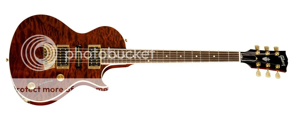

Nancy Wilson Nighthawk:
![nancy-wilson_zps3d340e30.jpg](/proxy.php?image=http%3A%2F%2Fi976.photobucket.com%2Falbums%2Fae241%2Fhackeiommi%2FGreco%2520and%2520Gibson%2520Last%2FNighthawk%2520Other%2Fnancy-wilson_zps3d340e30.jpg&hash=ce24dbbd556cc832280bbf2830f6b663)
![nancy-wilson2_zps628d20b6.jpg](/proxy.php?image=http%3A%2F%2Fi976.photobucket.com%2Falbums%2Fae241%2Fhackeiommi%2FGreco%2520and%2520Gibson%2520Last%2FNighthawk%2520Other%2Fnancy-wilson2_zps628d20b6.jpg&hash=987229ed19da6d551020265651f96d6d)
Tabii bunlar reklam kokan işler. Nancy Wilsonlar bana sorarsanız elimdeki Special'ın daha iyi çalışılmışı gibi duruyorlar sadece.

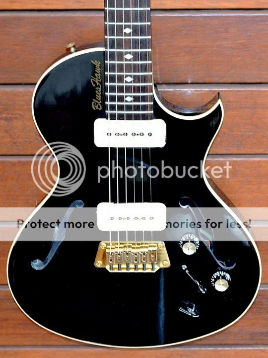

Nighthawk'ın Başarılı Ama Kıymeti Bilinmeyen Üvey Çocukları: Little Lucille ve Blueshawk
Arada blues sevenleri habersiz bırakmamak adına, Blueshawk ve Little Lucille modellerinin özet te olsa üstünde durmam gerek. Dediğim gibi serinin Fender takıntısından bağımsız ve daha uzun soluklu üretilmiş mühim iki modeli. Özellikle Blueshawk’ı kullananlar içinde bağımlısı çok.
Blueshawk modeli, adına yakışır blues tabanlı bir gitar. Gövdesi kavak ağacı, üstünde maple kapak. Semi hollow body. Denilene göre Fender manyetiklerdeki gibi noise canceling sistemli P 90 manyetikleri olan bir model. Telelerdeki gibi through-body stringing köprü hadisesine sahip. ES345 modellerindeki gibi bir mid cut devresi var. Beğeneni, takdir edeni çok. Hatta üretimden kaldırılması tepki de aldı ama, Gibson nedense bu tepkileri kavle almadı. Blues tutkunu bir gitarist iseniz, karşınıza çıkarsa, bu gitarı bir denemeye bakın. Sanırım bağımlılık yapmasının hayli geçerli bir nedeni olması gerek.
Little Lucille de Blueshawk’a çok benzeyen ve 98’den sonra üretimi devam etmiş bir diğer model. Hatırladığım kadarı ile BB King bu modelin endorseri idi. Gibson BB King Lucille’in değişiği, daha ufağı diyebiliriz. Modifiyeli P90 manyetikli, gürültü kesici bir sisteme sahip. Blueshawktaki mid cut devresi bunda da var. Bu da kavak ağacı gövdeye sahip. Üstünde maple kapak var yine ve tabii ki semi hollow body. Fakat bunda tune o matic köprü ve TP6 tailpiece mevcut. Nedense sağda solda kullananına, övenine bir türlü denk gelmedim. Ama Blueshawk kadar üretimde kalmasının da bir sebebi olsa gerektir.
Bu iki modelden özellikle Blueshawk, bayağı sevilmelerine ve diğer üç modelden daha uzun ömürlü olmalarına rağmen nedense, Nighthawk'ın yeni üretimleri piyasaya çıkarıldıktan iki yıl sonra, 2006’da üretimden kaldırıldılar. Blueshawk kullanıcıları bu duruma anlam veremediler, hatta biraz kızgınlar. Bakarsınız, bir on yıl sonra diğer Nighthawklar gibi tekrar üretim bandında arz-ı endam ederler, kim bilir?
Blueshawk:
![gibson_Blueshawk2_zpse101781a.jpg](/proxy.php?image=http%3A%2F%2Fi976.photobucket.com%2Falbums%2Fae241%2Fhackeiommi%2FGreco%2520and%2520Gibson%2520Last%2FNighthawk%2520Other%2FNighthawk%2520Blueshawk%2Fgibson_Blueshawk2_zpse101781a.jpg&hash=bba87d9bfc6a81aff7d9546be827eece)
![gibson_Blueshawk98_zps1cef9464.jpg](/proxy.php?image=http%3A%2F%2Fi976.photobucket.com%2Falbums%2Fae241%2Fhackeiommi%2FGreco%2520and%2520Gibson%2520Last%2FNighthawk%2520Other%2FNighthawk%2520Blueshawk%2Fgibson_Blueshawk98_zps1cef9464.jpg&hash=c632f31ca0ef8dc8bebf054475a369cc)
![gibson_Blueshawk_zps07c39c10.jpg](/proxy.php?image=http%3A%2F%2Fi976.photobucket.com%2Falbums%2Fae241%2Fhackeiommi%2FGreco%2520and%2520Gibson%2520Last%2FNighthawk%2520Other%2FNighthawk%2520Blueshawk%2Fgibson_Blueshawk_zps07c39c10.jpg&hash=a42054f17e4ffe359bc2af2d6488ad30)

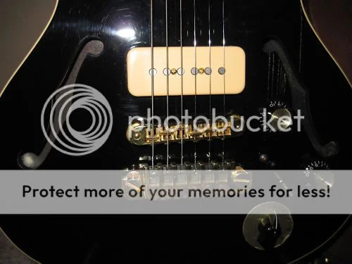

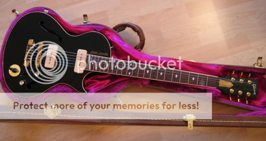

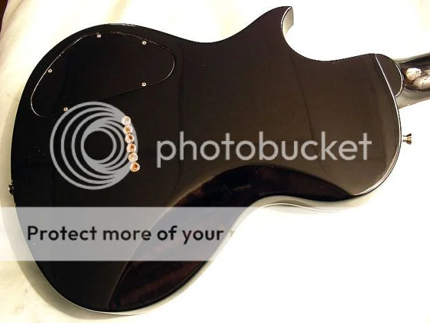

Little Lucille:
![Gibson_Little_Lucille_zps398919fb.jpg](/proxy.php?image=http%3A%2F%2Fi976.photobucket.com%2Falbums%2Fae241%2Fhackeiommi%2FGreco%2520and%2520Gibson%2520Last%2FNighthawk%2520Other%2FNighthawk%2520Blueshawk%2FNighthawk%2520Little%2520Lucille%2FGibson_Little_Lucille_zps398919fb.jpg&hash=ee59acc233d641ba9f7df229b400c85f)
![Gibson_Little_Lucille4_zps0f7e49e7.jpg](/proxy.php?image=http%3A%2F%2Fi976.photobucket.com%2Falbums%2Fae241%2Fhackeiommi%2FGreco%2520and%2520Gibson%2520Last%2FNighthawk%2520Other%2FNighthawk%2520Blueshawk%2FNighthawk%2520Little%2520Lucille%2FGibson_Little_Lucille4_zps0f7e49e7.jpg&hash=cfcfb0db84e2ec6dbbc6a2450ee8eceb)
![Gibson_Little_Lucille2_zpsa0e2e36a.jpg](/proxy.php?image=http%3A%2F%2Fi976.photobucket.com%2Falbums%2Fae241%2Fhackeiommi%2FGreco%2520and%2520Gibson%2520Last%2FNighthawk%2520Other%2FNighthawk%2520Blueshawk%2FNighthawk%2520Little%2520Lucille%2FGibson_Little_Lucille2_zpsa0e2e36a.jpg&hash=9376464d1a61cb4979851f4f8a6b3fde)
